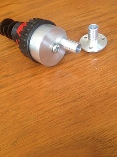

I have been running with this re-breather for over 3 years now and we race 12 months per year plus do some cruising in the summer. I haven't had any problems to date. My observation is that because my tube mounts vertically to the top of the fill cap, the oil fumes condense as they rise and cool coming out of the cap and into the hose. Then, any condensed oil probably runs back down into the engine via the same route it came out of when the engine is not running. No idea how it gets past the reed valve, however I can see some oil residual in the clear hose up to about 100mm above the attachment to the cap, but none beyond that, so I'm guessing that is what happens. I think it never makes it to the air filter. I took my cap off the other day and neither was there any accumulation of oil between the top of the cap and my re-breather cap. If one makes one of these gismos, I can advise that if you use that clear reinforces plastic hose that is on Voila, it may look upon installation that it stands up nicely to bridge between the oil fill cap and the air filter. However when the engine compartment heats up, the plastic goes temporarily soft and will sag onto the flywheel. I support mine by suspending it from the bottom of the cockpit sole, or the top of the engine compartment.
Finally, I am not afraid of engine damage at this point and the arrangement keeps my boat smelling fresh when running and also keeps my engine compartment much cleaner that having the oil fumes condense all over the place at large after escaping the original oil cap into the atmosphere.

The air filter in the snorkel is actually only a wire mesh screen so oil won't clog it. I keep my snorkel vertical. If your worried that your collecting too much oil in it you could drill a hole in the bottom outside of the wire screen and this would allow it to drain in to a catch can.. or even on to a rag. I haven't collected any oil in my snorkel in the 2 years it's been installed. If you do not use your engine with the boat heeled it won't be an issue. And if you do you should be wise enough to check it out occasionally. This device isn't meant to compensate for using the engine when heeled. It's only to keep the crankcase fumes separate from the air you breathe down below.
Catch cans on cars are meant to drain automatically back into the engine. To do this on this engine it would have to be mounted above the oil filler neck of which there isn't much space between the cockpit floor and the top of it.

i agree , nice work. The drawback is that you must now check your air filter more often as that oil mist will clog it up. Running the lines into the filter housing downstream from the filter would avoid this, but should the Buhk take a big gulp of oil that has pooled in the bottom of the housing the con rod will suffer (hydraulic lock). The reed is there to generate negative pressure in the crankcase so that the seals are not blown out. Pollution controls on cars plumbed this back into the air intake as you have done -PCV valve. They do not heel like a laser so there are no big discharges that could cause problems. Cars that sustain high G forces pump their oil into a tank to avoid this (Dry Sump).
This was on a lot of classic motorcycles in the past but now internal baffles prevent large losses of lubricants. You can't make a silk blanket from a sow's ear but you have greatly improved what is at best a very old design.Big smile

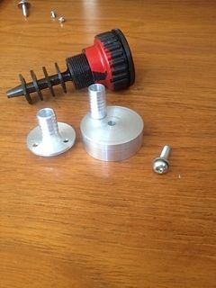

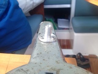

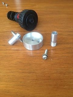

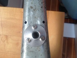

frfletch View Drop Down
Joined: 13 May 2008
Location: Canada
Points: 365
Post Options Post Options   Thanks (0) Thanks(0)   Quote frfletch Quote  Post ReplyReply Direct Link To This Post Posted: 29 August 2014 at 11:37am
Hi All. I finally got to the project of the re-breather for the oil cap and tested it earlier this week. It works.

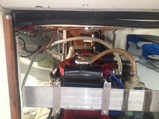

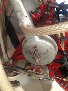

hi Dick,
It looks to me from your photo of the drive leg filler hose that you have the plastic plug there already. It looks hollow from the top, but is actually a plug at the other end. Slacken the hose clamp holding it and it should pull out of the hose for re-filling drive leg after draining. (might be time)
Nice to see that extra fitting brazed on the air intake so as not to restrict amount of combustion air to engine.
Good work...
George
Joined: 13 May 2008
Location: Canada
Points: 365
Post Options Post Options   Thanks (0) Thanks(0)   Quote frfletch Quote  Post ReplyReply Direct Link To This Post Posted: 06 July 2014 at 3:52am
Ok! I think I will machine a new metal cap for the oil filter such that it preserves the current reed-valve assemble, but the cap can have an outlet on it to which we can connect a small breather tube. I'm thinking 3/8" silicone hose that is easy to bend and route anyway we want. I'll send some photos when done.

Post Options Post Options   Thanks (0) Thanks(0)   Quote Bill Layton Quote  Post ReplyReply Direct Link To This Post Posted: 05 July 2014 at 10:19pm
The hose from the saildrive leg  is it's oil fill hose. It came with a plastic plug on that end.
You could always ty-rap and screw the 3/8" hose to the underside of the cockpit and drop it down by the air filter, leaving some wiggle room. Keeping that hose vertical until it hits the cockpit is probably desirable should oil ever get into it.
Mad Max View Drop Down
Skipper
Skipper
Joined: 18 June 2010
Location: Buffalo NY
Points: 55
Post Options Post Options   Thanks (0) Thanks(0)   Quote Mad Max Quote  Post ReplyReply Direct Link To This Post Posted: 05 July 2014 at 8:57pm
Here are the pictures.  There was no oil in the air cleaner from the hose.  Pic with filler cap apart you can see the rubber gasket which keeps air from getting sucked in as Bill mentioned.  New attachment for hose is brazed onto air breather.  Will need to make trip to auto parts store for new hose to go over filler cap which is a hair over 1 3/4".  I hoping it won't touch fly wheel when installed.  In the last picture you can see a hose which comes from lower housing unit and sits just below the flywheel.  Is there something missing or does it just sit there open?  Looks like a dip stick tube or is it just a vent?
https://flic.kr/s/aHsjYNW4kF
Dick #122
