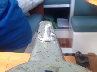

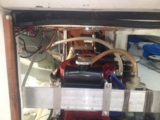

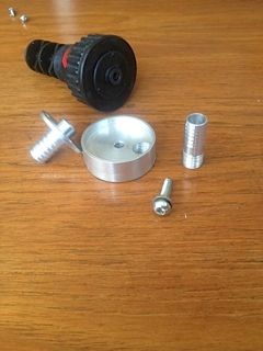

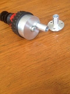

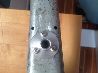

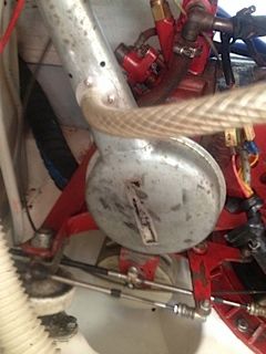

Hi All. I finally got to the project of the re-breather for the oil cap and tested it earlier this week. It works.
http://s1124.photobucket.com/user/ratbagg/media/BUKH%20Breather%20modification/utf-8IMG_1025.jpg.html">
http://s1124.photobucket.com/user/ratbagg/media/BUKH%20Breather%20modification/utf-8IMG_1015.jpg.html">
http://s1124.photobucket.com/user/ratbagg/media/BUKH%20Breather%20modification/utf-8IMG_1021.jpg.html">
http://s1124.photobucket.com/user/ratbagg/media/BUKH%20Breather%20modification/utf-8IMG_1020.jpg.html">
http://s1124.photobucket.com/user/ratbagg/media/BUKH%20Breather%20modification/utf-8IMG_1013.jpg.html">
http://s1124.photobucket.com/user/ratbagg/media/BUKH%20Breather%20modification/utf-8IMG_1019.jpg.html">
http://s1124.photobucket.com/user/ratbagg/media/BUKH%20Breather%20modification/utf-8IMG_1014.jpg.html">

I have been running with this re-breather for over 3 years now and we race 12 months per year plus do some cruising in the summer. I haven't had any problems to date. My observation is that because my tube mounts vertically to the top of the fill cap, the oil fumes condense as they rise and cool coming out of the cap and into the hose. Then, any condensed oil probably runs back down into the engine via the same route it came out of when the engine is not running. No idea how it gets past the reed valve, however I can see some oil residual in the clear hose up to about 100mm above the attachment to the cap, but none beyond that, so I'm guessing that is what happens. I think it never makes it to the air filter. I took my cap off the other day and neither was there any accumulation of oil between the top of the cap and my re-breather cap. If one makes one of these gismos, I can advise that if you use that clear reinforces plastic hose that is on Voila, it may look upon installation that it stands up nicely to bridge between the oil fill cap and the air filter. However when the engine compartment heats up, the plastic goes temporarily soft and will sag onto the flywheel. I support mine by suspending it from the bottom of the cockpit sole, or the top of the engine compartment.
Finally, I am not afraid of engine damage at this point and the arrangement keeps my boat smelling fresh when running and also keeps my engine compartment much cleaner that having the oil fumes condense all over the place at large after escaping the original oil cap into the atmosphere.

Sorry. I made this item up for you and then moved my shop. I will find it and send it. Please send me your mailing address.

Did this upgrade , easy to do . will let you know if it worked . I note that I was surprised that the crankcase is sealed and the reed valve seems to be there to let presure out but there is no "intake" so the air does not seem to flow through . I guess you are just catching the blowby ?
