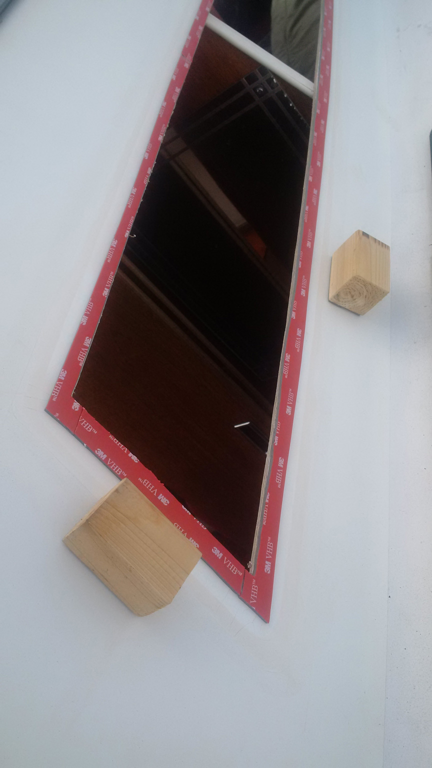

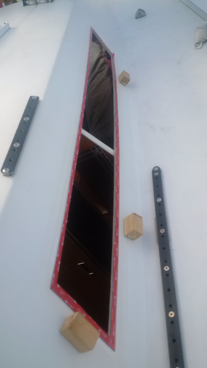

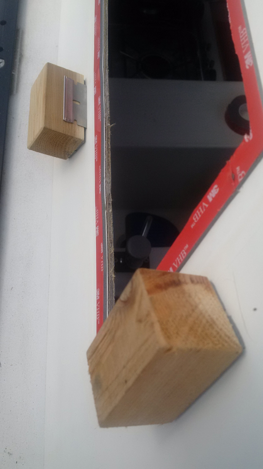

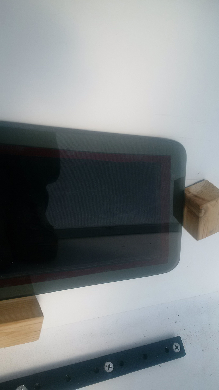

Once your old windows are removed and all cleaned up, reinstall the windows temporarily with a few fasteners to hold it in place. At this point I stuck a few blocks of wood in place on the deck using a removable 3/4 inch shim between the block and the old windows. The blocks will be used to locate the new window for installation. I used the same 3M VHB tape on the blocks of wood.
The photos below show the blocks and 3M VHB in place ready for the new windows.
Once the new windows are in place and adhered to the 3M VHB tape you can remove the locating blocks. Use masking tape and paper as needed around the window and on the outside of the window to allow for easier cleanup after applying the Dow Corning 795 as this can be a challenge to fill the space, you may need a spatula to help push in the sealant. I used black sealant so taping is important for the cleanup.

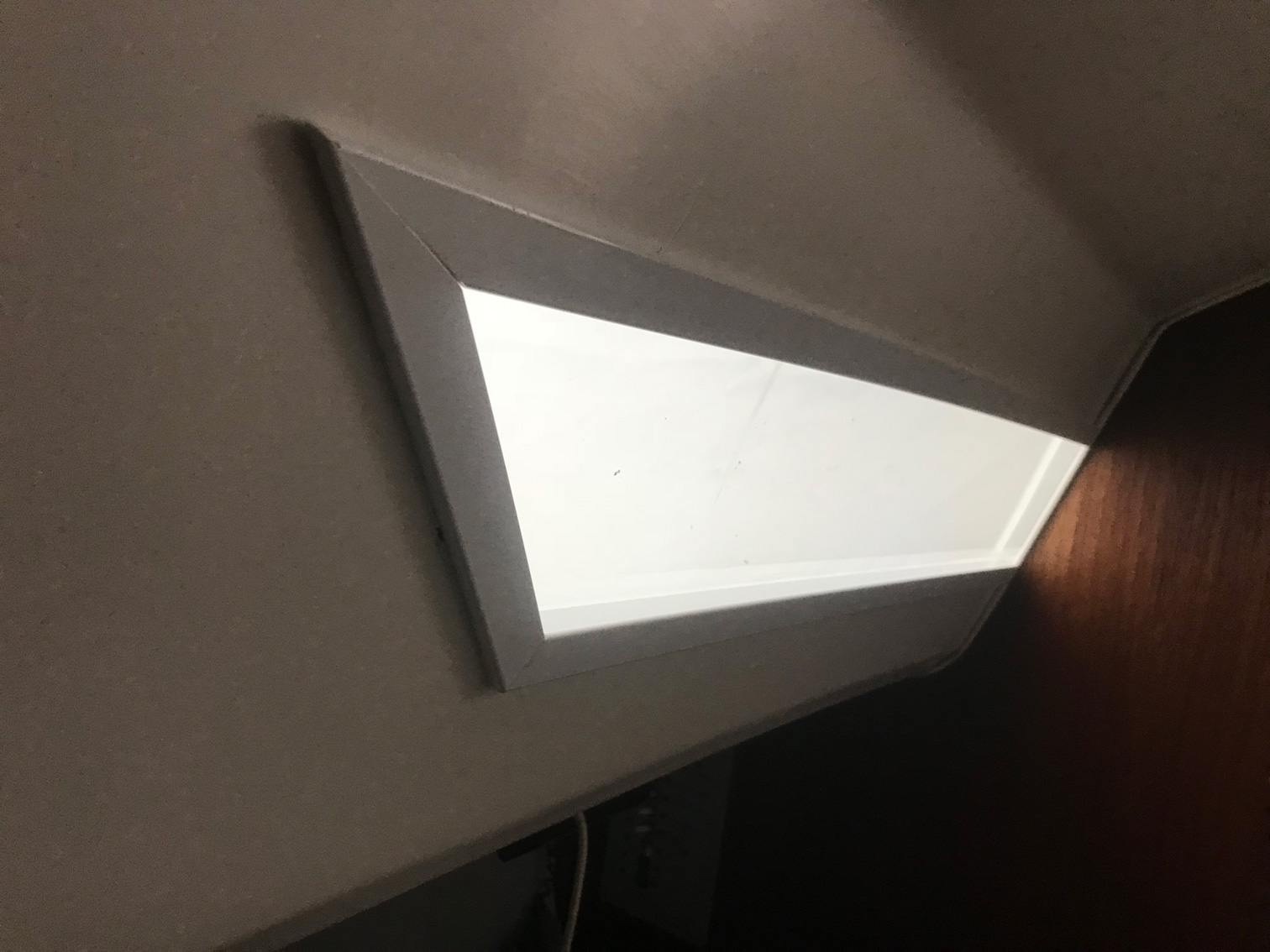

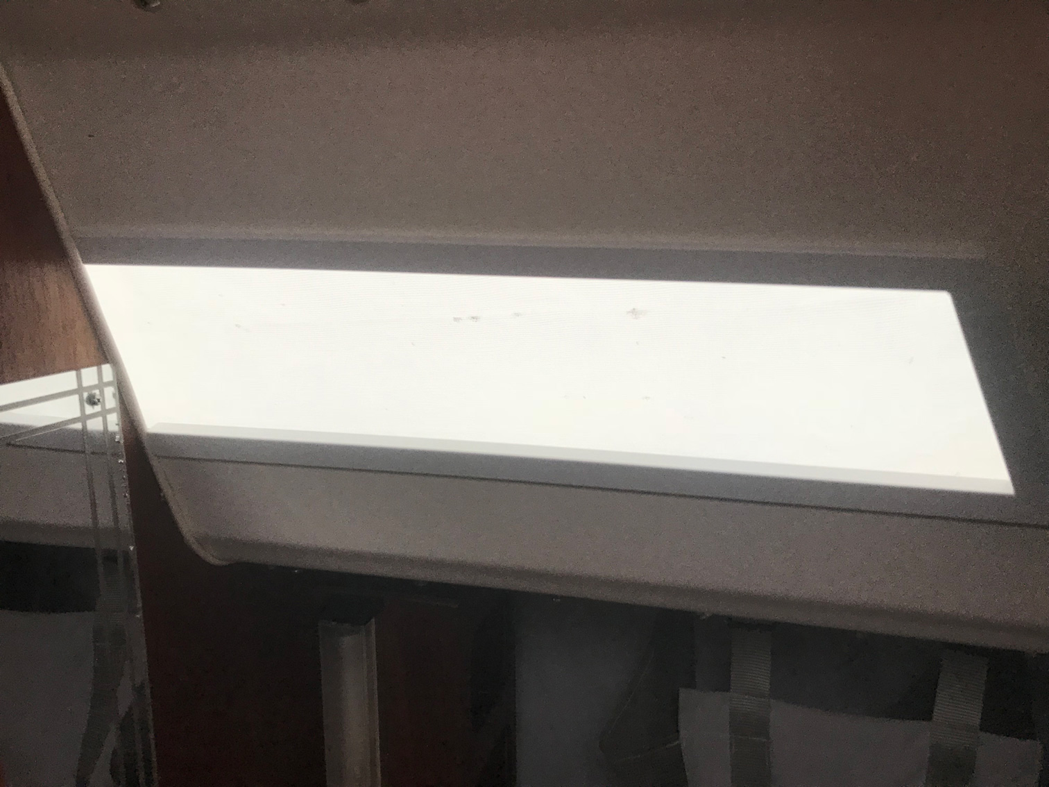

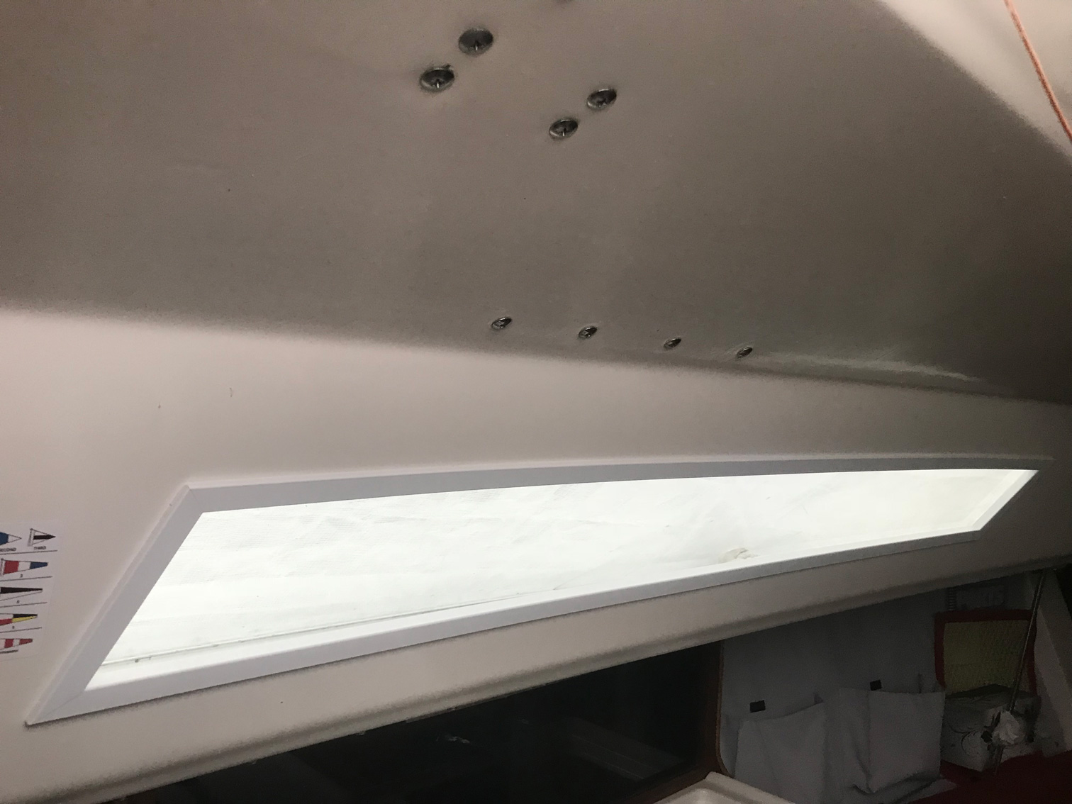

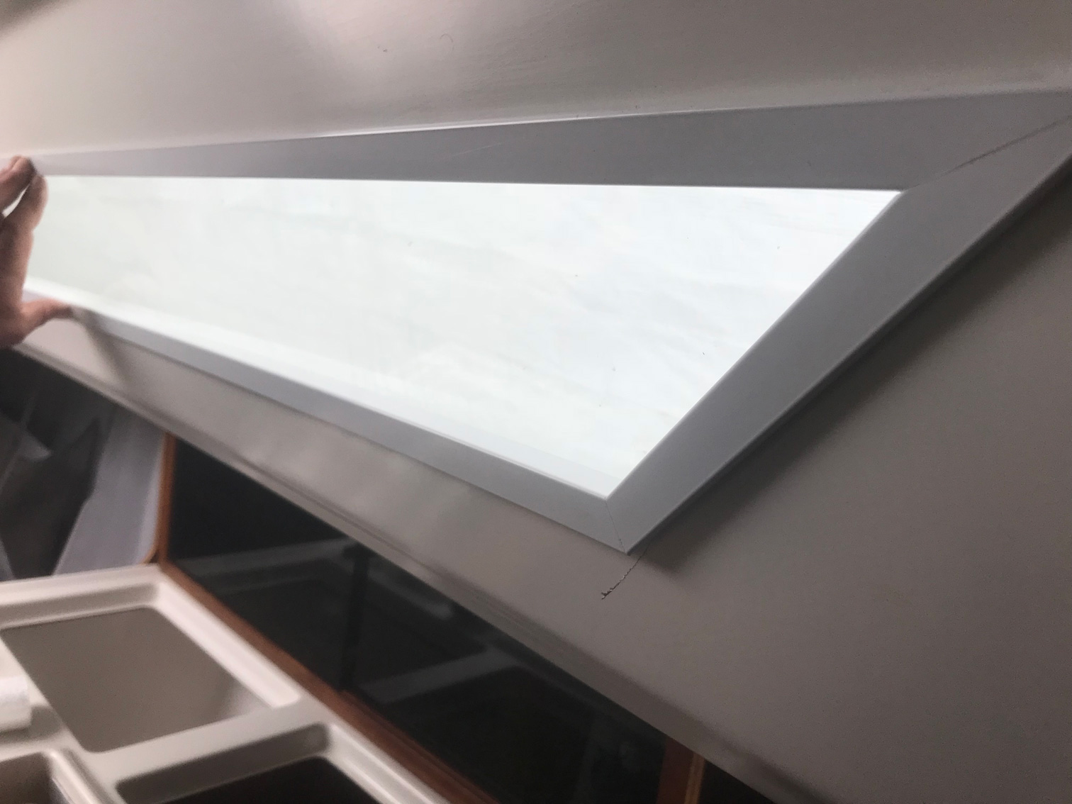

On the inside I used 1/8 inch thick plastic angles to make new mouldings. One side was cut down to fit the horizontal surface, I made allowances as I used the same 3M VHB on the vertical surfaces to stick the mouldings in place. The corners were mitered and glued.
Looking back I should have blacked out the edge of the moulding against the window as the white can be seen from the outside.

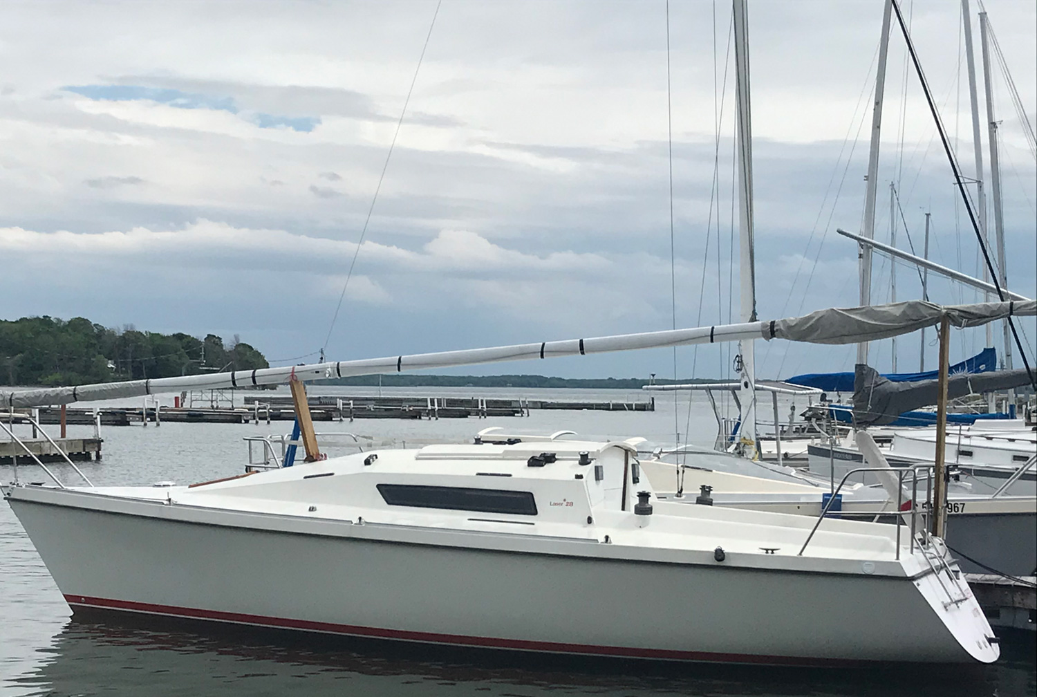

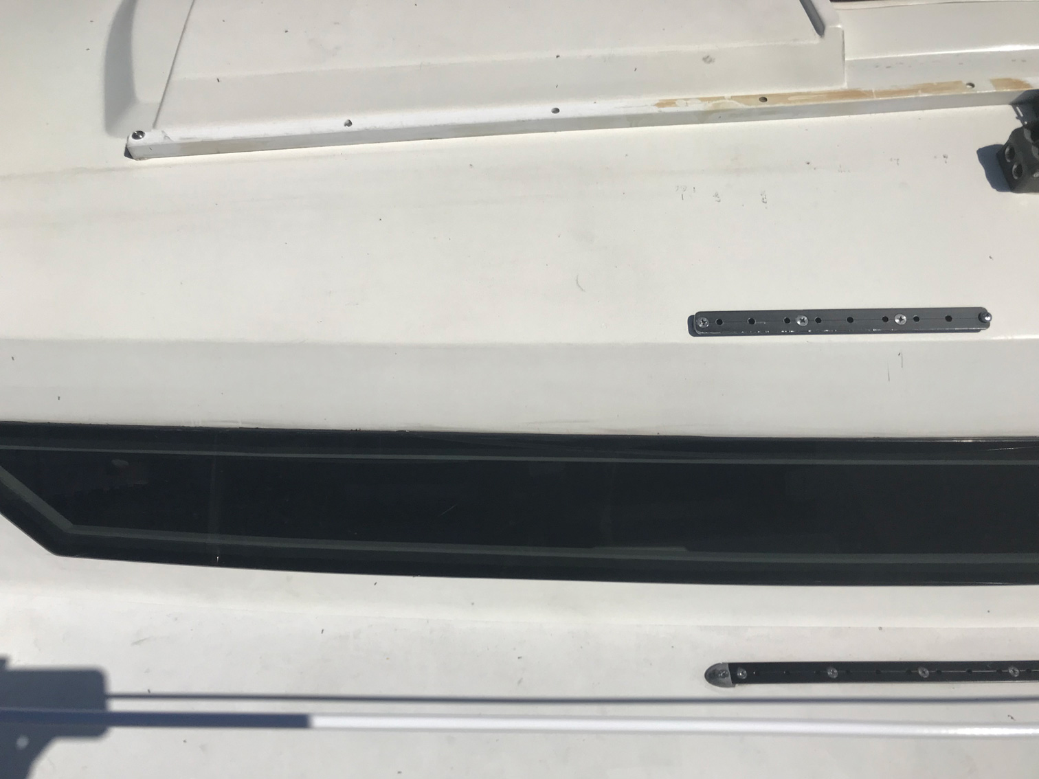

Here's a photo where you can see the difference in windows on Decompression versus the original windows.
I'm very happy with the result, no leaks and it looks very clean. The image quality is low in some cases as the boat was under a tarp.
