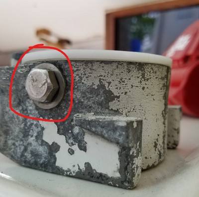

Was anchored in rougher weather this last week and noticed I had significant tiller/rudder play that I would like to fix.  Read a number of posts on the forum such as:
 - Rudder Solutions
 - Tiller Play
 - Rudder Ring
 - Rudder
 - Removing Rudder in Water
Lots of great information but I still don't fully understand how the tiller and rudder are assembled.  Is it the one (1) through bolt the only thing holding them together?

Post Options Post Options   Thanks (0) Thanks(0)   Quote fatjohnz Quote  Post ReplyReply Direct Link To This Post Posted: 30 July 2024 at 9:04pm
You've got it right Geoff.
The rudder shaft is stainless steel and embedded into the rudder. If you take that bolt out, be ready to catch the rudder; it doesn't float.
The play comes from wear in the aluminum cap (pictured) because the SS bolts have worn the original holes.
I've tried some flexible bushings but they didn't hold. I think the prescribed fix is to drill the aluminum and insert hard bushings.
The nylon bushing you have in the pic adjusts the vertical play between the cap and housing.

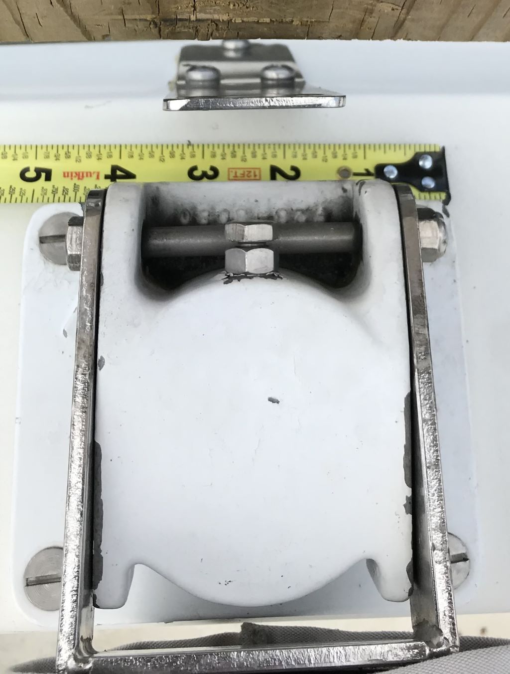

As you mention, the bolt holes in the casting tend to become oblong over time. My solution was to drill and tap the aft side of the rudder casting for a 5/16" bolt (with the casting removed) and then use a bolt as an adjuster to take out the play along with a nut to lock the bolt. See pic below from an overhead perspective.
L28 Rudder Casting Adjuster
