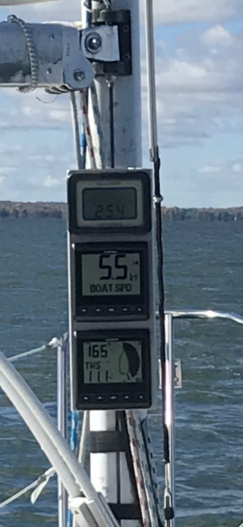

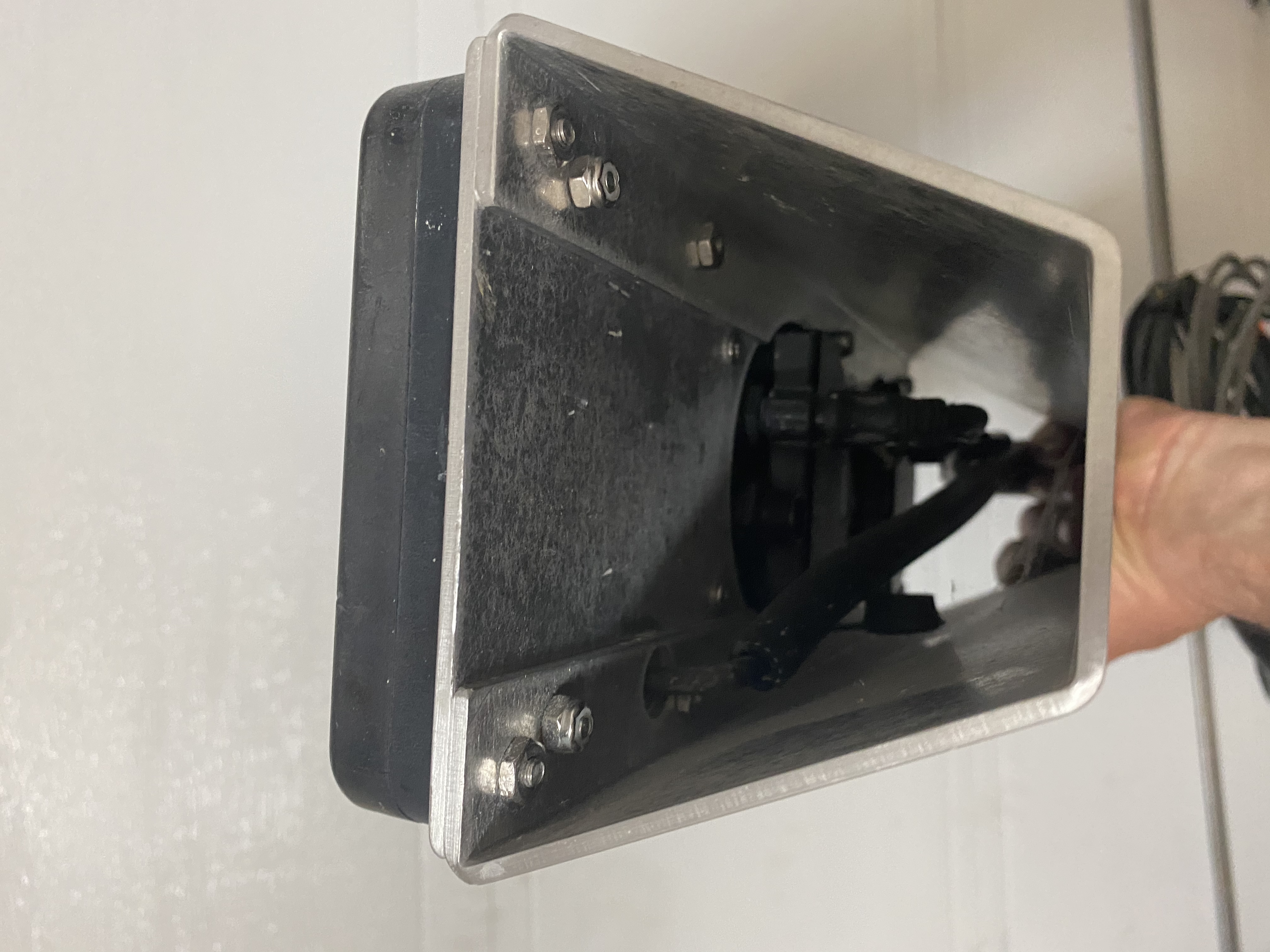

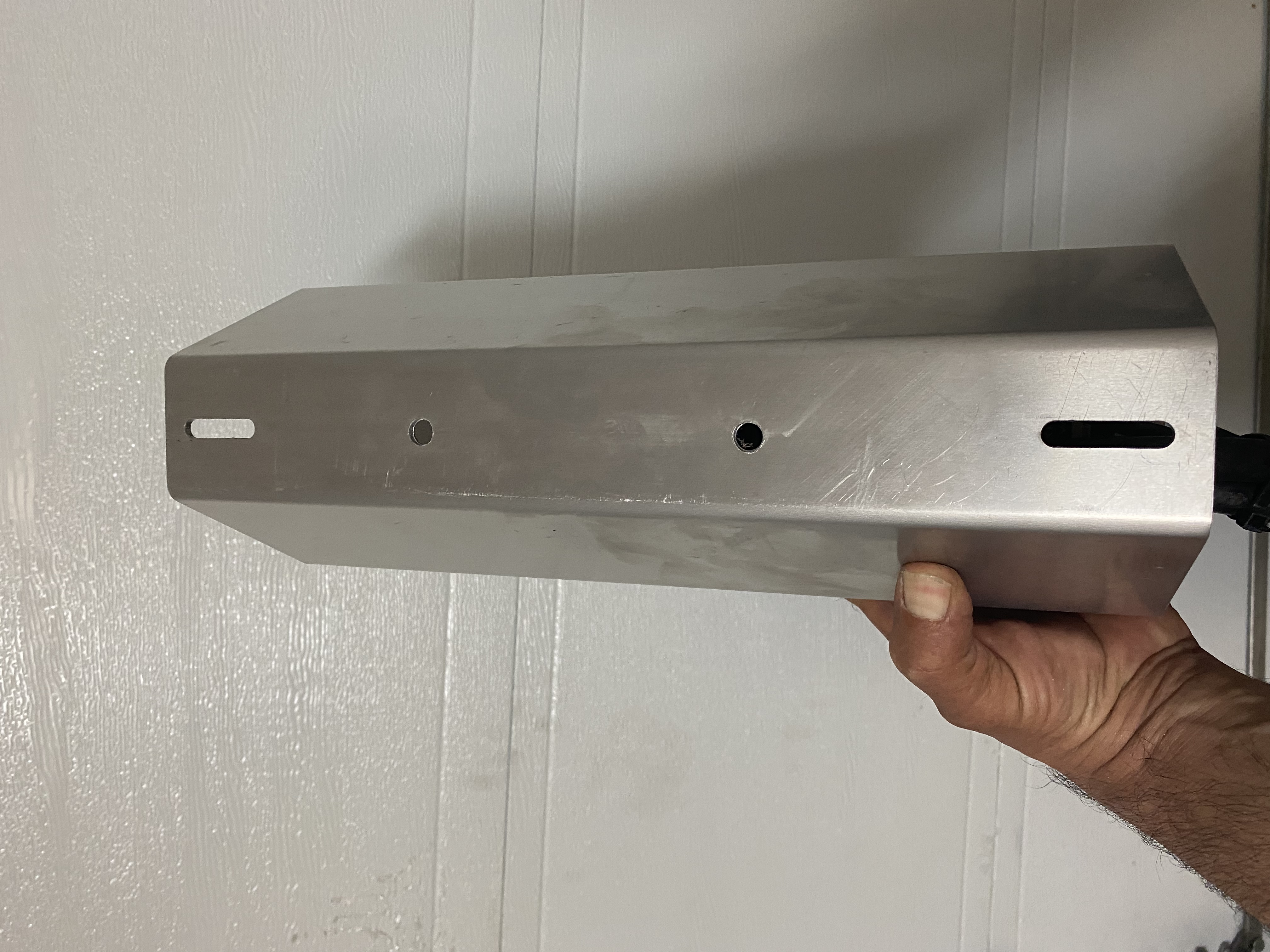

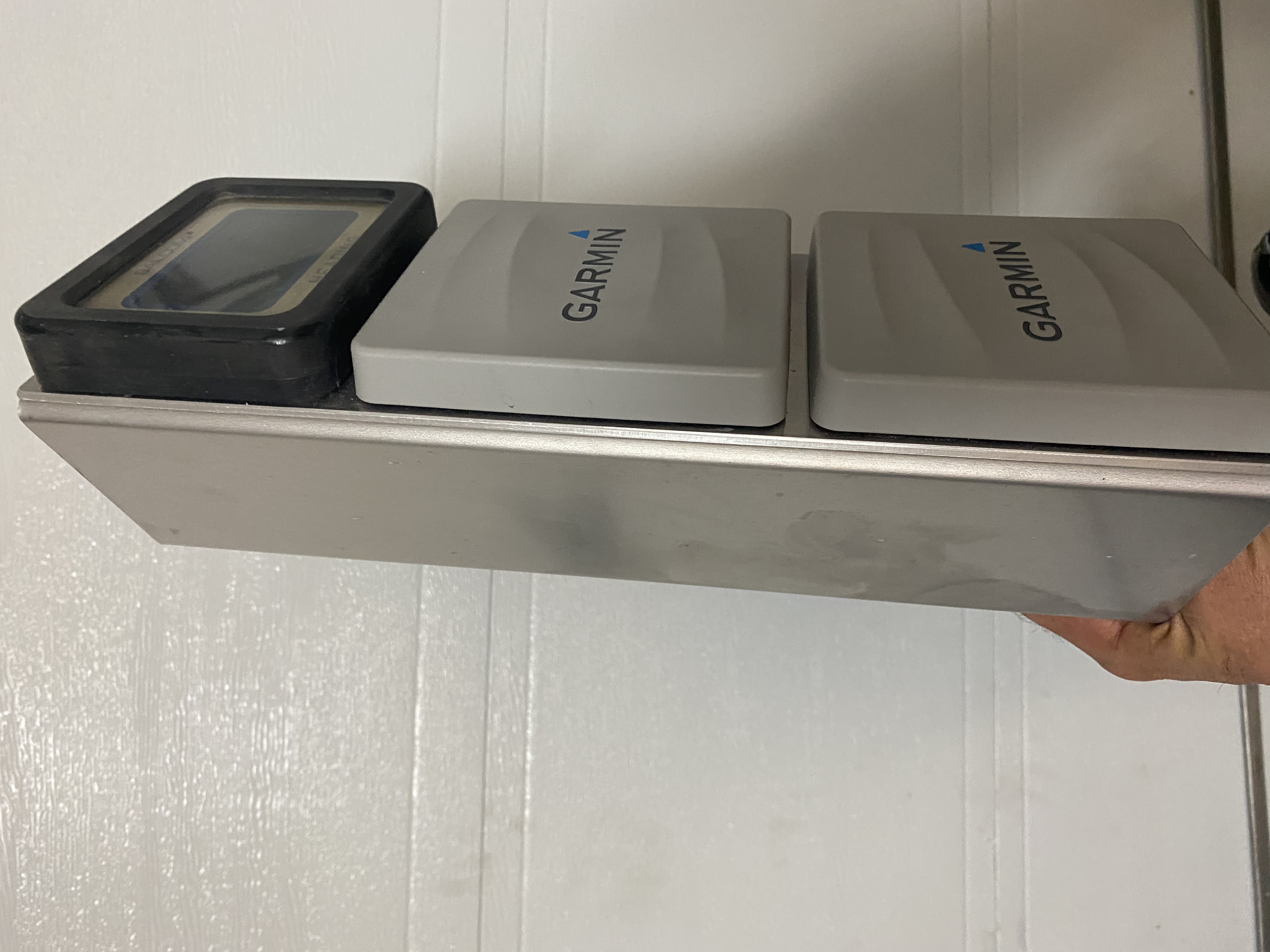

Here's how I have mine setup. This is a custom made bracket, not expensive to have made if you can draw the bracket yourself, this one cost about $60.
I drilled and tapped holes in the bolt rope groove in the mast and use 2 fasteners. ![]() ![]() ![]() ![]() Edited by Foghorn - 22 May 2021 at 11:48am |
