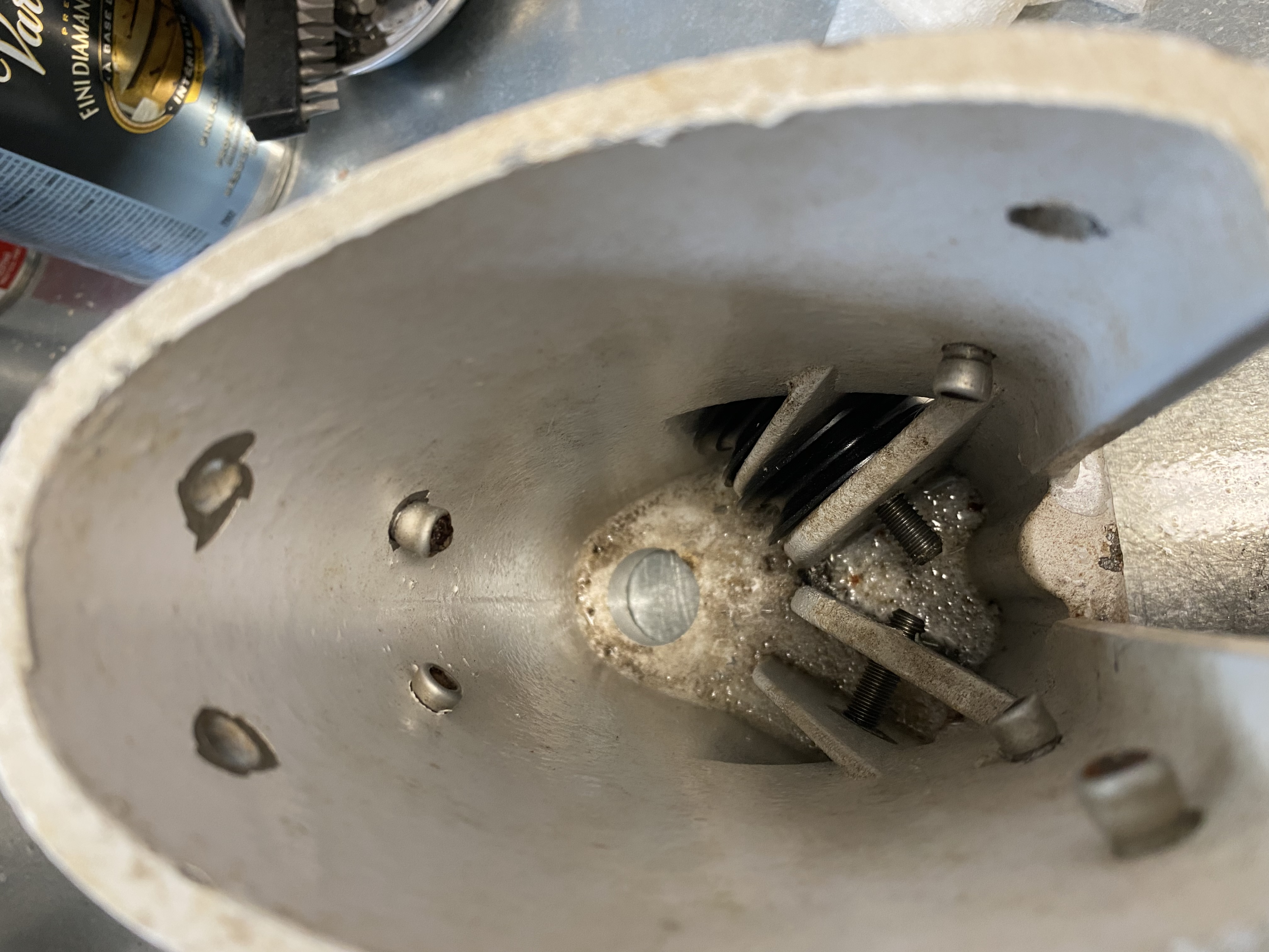

No nuts in the mast base casting, the sheave flange is tapped.
Decompression CAN 214 |

Hello, Do you need to drop the mast base to service the lower sheaves? I tried to remove the bolt(s) with the mast raised and the bolts bound up. I'm thinking there is a nut inside the base. Is that correct?
thanks, john |
