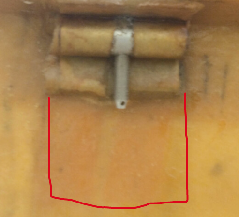

Some of the early boats have indeed failed in this area and we had to cut into the white glass liner where it bonds onto the hull underneath the tie-rod barrel. There is an angled edge approx, 18" lower than the tie-rod barrel, for example this is where the edge of the table sits when folded down against the side of the hull. It's the next loaded area after the flanges above. (the port side is similar) That edge is the bottom of the flat panel that extends downwards from the tie-rod barrel. I have seen this pull out on 2 early boats. One time the flange had popped and sailed popped for some time before being noticed which assumably led the lower part to let go and the other boat may have had an impact on the side of the hull. This last boat had it's flanges re-glassed some years earlier and then the lower part popped. It left that whole flat part of the white panel distorted and wrinkled. Once cut out and reglassed it was fine. To do any of these tie-rod repairs the boat has to be on the trailer or cradle with the mast down so those areas are not loaded. Furthermore, before I start the job I loosen the tie rods off and loosen the pads off on the trailer/cradle so that the boat is sitting nearly 100% on it's keel. After sitting like this for a day or two I always found the distorted glass fell back into place and I just had to cut into it and glass it into the hull (the bottom part), refair it and I usually coat it with white epoxy and leave it. As doing it in gelcoat would be very time consuming.

Can I assume the shelf itself is providing the majority of the structural strength? Does anyone have any photos of how they glassed in the steel block holding the rod and the repair on how the glass shelf was cut out? Has anyone considered increasing the "height" of the steel block so it has additional bond to the vertical bulkhead? I would think that the structural strength would be stronger along the bulkhead length rather than relying on the "Z" of the shelf bend. ![]() Edited by Geoff Coke - 02 July 2022 at 12:11pm |
